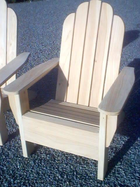

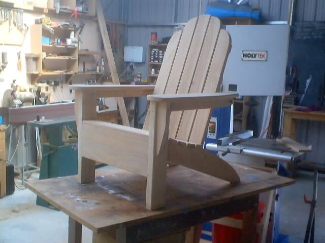

Here is pic that I mentioned I would post.
http://i31.photobucket.com/albums/c387/brian1520/00000.jpg
Very nice -- looks like you used 1 1/2" stock for the legs, and then 3/4" or 1" stock for the seat and back slats. I like that idea.The only part I am not sure about is the stretcher across the front legs. What made you decide to use one that wide?The wood is terrific -- what is it?********************************************************

The wood is http://www.cypress-sawmill.co.nz/macro/macro.htm
To be honest I think the same,I just followed the plan.
Cypress? From the USA? And you bought it in NZ?Nobody stocks it around here, unless I have it shipped in.********************************************************

Macrocarpa,grow lots of it here.
Pic not good due to mediocre camera.See if this one is a bit better.
http://i31.photobucket.com/albums/c387/brian1520/00040.jpg
The cypress link you included talked about grown in USA, so I thought they were shipping it to NZ.This pic is good on my end, but so was the first one.Nice job on the chair -- what I would call a clean rendition.********************************************************

That is where the trees originated.USA.
The bit at the front you mention,isn't one piece,the rear legs have a piece at the front which sits on strecher.If you look carefully you will see the join.
