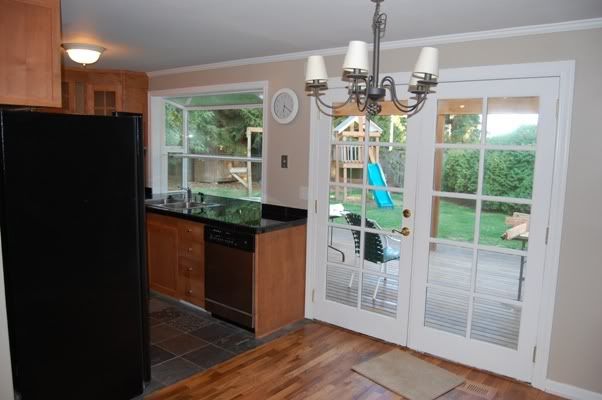

I was in a similar situation - bigbox cabs were junk, and after a couple of quotes well past $7k for a 8x10 kitchen I rolled up my sleeves and dove in. All birch ply, prefinished. doors and drawer faces are sold maple. The key was that the space demanded a custom look to really take advantage of the space with the garden window (the entire kitchen was rotated 90 degrees clockwise, necessitating moving the water+waste and gas lines as well as vent ducting and heat ducting). The result: pics attached.
http://i236.photobucket.com/albums/ff91/bradgobble/kitchen.jpg
http://i236.photobucket.com/albums/ff91/bradgobble/kitchenandwindow.jpg
Looks great and similar to ours. We didn't have to move any pipes.
I did flat panel (Maple veneer) door and drawer fronts. Black granite slab counters and black granite tiles on the floor and backsplashes.
