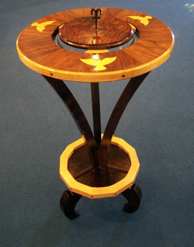

I used the Titebond Cold Press veneer glue with out a veneer press on this Baptismal Font. OPen time is good enough if youy need to fuss around.
http://www.woodwardwoodworks.com/DCP_2130_edited_op_627x800.jpg
http://www.woodwardwoodworks.com/DCP_2118_edited_op_800x404.jpg
