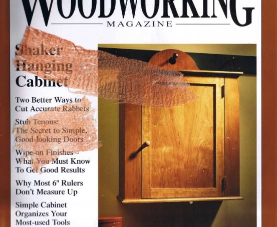

I have used both my LV large scraping plane and LN small scraping plane on curly claro walnut, also with a tendency for tearout (See my gallery post from last week on Newport tall case clock) I find that with the curly woods or crotch woods I can rarely go straight from the plane to the finish without sanding. Even on straight grain woods like mahogany, the finish is more glassy smooth with a card scraper than with the bevel down LN number 4.

And here is one of those silly, but fun thin shavings of Jarrah taken with the BUS ..
