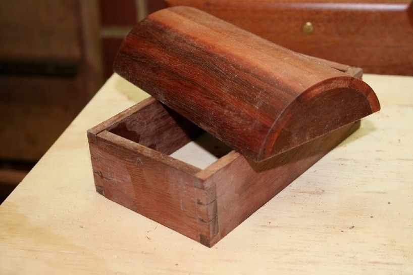

There is a pictorial in my blog that may help: https://www.finewoodworking.com/item/13200/coopering-a-box-lid
Thank you for responding.
Your blog instructions are very straight forward and pictures complete th process. Great!!!

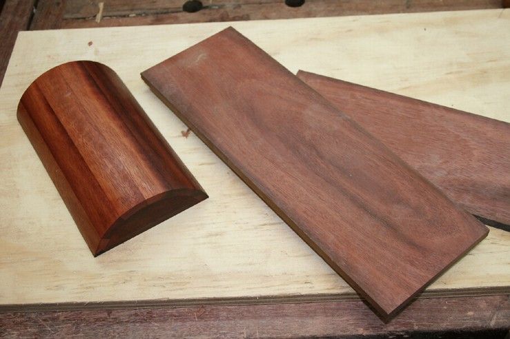

After drawing the angles on the end pieces, wouldn't it be easier to saw off the waste rather than chiseling?
How thick was the wood that you used?
Marquetry
Hi Marquetry
You asked ..
No. The surface angles are never exact. The profile needs to be scribed so that it fits exactly. Chiseling is more accurate than sawing.
From memory it was around 1/4" (perhaps 3/8") thick.

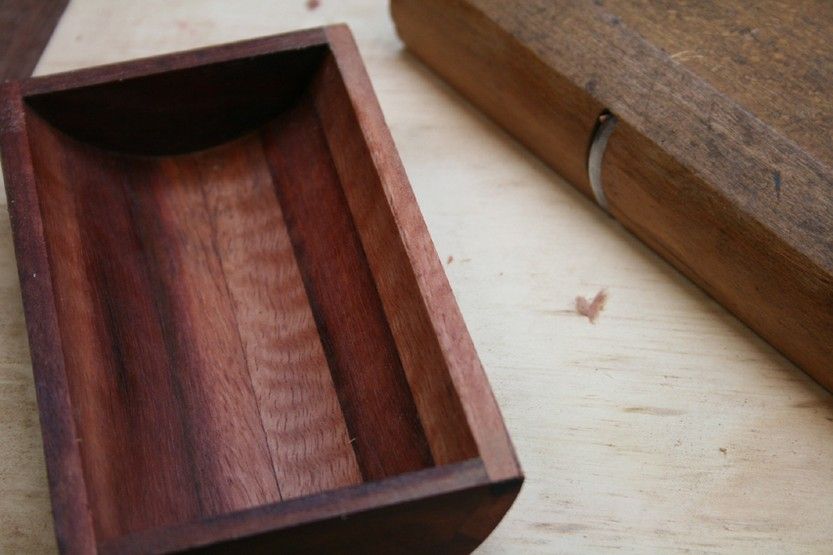

Here is a bit more to add to the blog.
I am in the process of building another box with a coopered lid (this one ordered by my better half). The lid is done.
This time I hollowed the interior as well - with a Round plane...
This is the current state - rough box, freshly dovetailed and glued. Still to be planed, etc.
