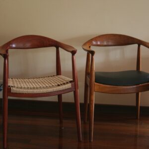

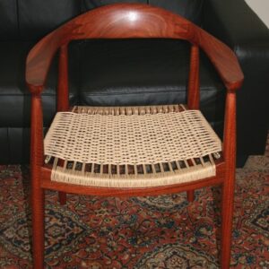

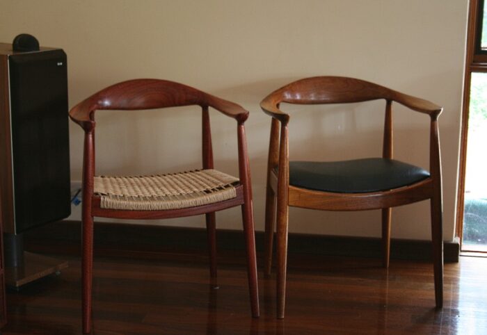

I admire Tom's work, both as a teacher and as a maker, but that chair is a rather inaccurate copy of the Wegner Round Chair. I can say this as I own an original and have built a copy in Jarrah. Mine won an award at Pop Wood magazine a number of years ago.
There is a complete build along on my website. Scan down this Index page: https://www.inthewoodshop.com/Furniture/index.html to "Building Hans Wegner's "The Chair"

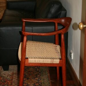

There is a photo below alongside an original (mine is the one with the woven seat). The famous "dovetail" joinery is not clear in this photo, so I added another at the end. Tom's version does not include this.
“The Chair”, as it is affectionately called, also nicknamed “The Round Chair”, was known to Wegner by its number, which was PP501. This had a corded seat. He later produced a PP503, with a solid seat. The original version was designed in 1949.

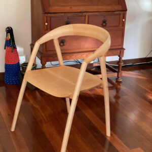

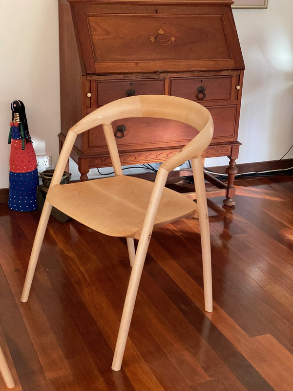

A second design is another Mid Century style, the DC 09, designed by the Japanese- Scandinavian duo, Kyoko Inoda and Nils Sveje, in 2011. It is built by the Miyazaki factory in Japan. A couple of photos below. Made in Hard Maple. This one I only had photos to go by, and it took me a great deal of research to work out the dimensions. This build is also on my website (use the above link and scan down to "Dining Carver Chairs").

SF, look at the build(s) and let me know which measurements you need. However, I am not sure that measurements alone would help. What you really need are drawings so as to create templates. There are positions, angles and curves, and some of these are subtle, but they interact to affect the whole appearance. Working from photos alone is a HUGE challenge. My recommendation for someone starting down this path is to purchase a cheap replica and make the templates from this. I would have done this for the DC09 if I had known they were available. You can refine the shape at the end.
