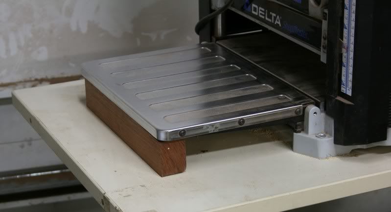

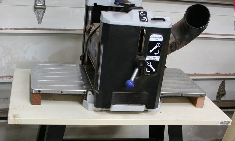

My lunchbox planer ("thicknesser" on this side of the Indian Ocean) is a newish (old stock) Delta 540. Below is the modification I made that has eliminated snipe.
The problem lay with the infeed and outfeed tables moving. These balance on the frame end up bending slightly with the weight of the board, first as the weight rests on the infeed side and then when the weight moves to gthe outfeed.
My solution was simply to prevent the tables from deflecting at all.

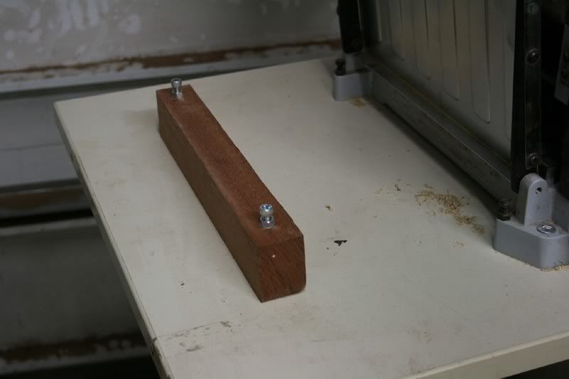

To do this I added rests under the tables. These used allen bolts to add a degree of adjustability ...
This works well for boards up to 4-5 feet. After that I clamp a rigid platform to extend the tables.
