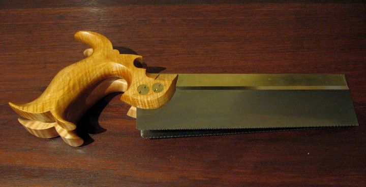

I picked up the saw at the Post Office this morning on the way to the Perth Wood Show. Over at the Fine Woodworking stand (a woodworking group I am a member of), I was able to try it out alongside a demonstration of saw sharpening (being run by a friend, who co-opted me into the demo). The demonstrator had his LN Independence on hand, and so I was able to try them out together. Well, I was impressed! The Independence cut more smoothly than the LN and there was no hint of grabbing on the piece of hardwood I was given (not sure what it was).
Back home I had a chance to do a short comparison with my LN, this time on Jarrah. How did the IT fare? The LN cuts well but it will grab at times (without warning). This new Independence is smooth and never grabbed, yet appears to cut as quickly/aggressively as the LN.

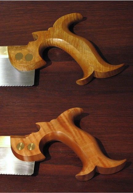

The two saws are very similar on a physical level, but there are differences.
LN op top, IT at the bottom
Both blades are 9” long. Both have Curly Maple totes. Both are filed 15 tpi rip.

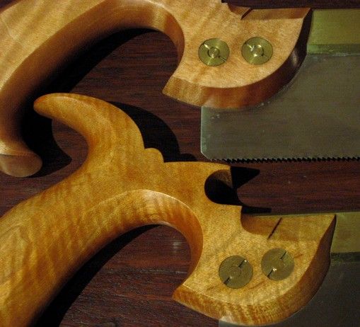

Side-by-side it is very evident which is which. The LN has the more polished, better finished woodwork. However it looks machined, whereas the IT has a softer and rounded profile, one that looks Made by Hand.

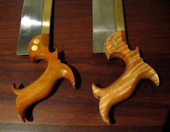

IT at left, LN at right
Saw nuts:
So how do they compare in the hand? The totes feel quite different. The IT is softer, rounder than the LN but it is also thinner. The IT is 22 mm thick vs the LN at 23.5 mm. Across the center of the tote the IT is 33 mm thick while the LN is 36mm. The LN feels more substantial while the IT molds into the palm. I can see that this would polarize users – some will prefer the LN while others will prefer the IT. I need more time to decide.

Both saw handles, while pretty, are doomed to lose those curlicue tips if the saws see any real use, the IT first because they are too skinny
Tha attached photo is the basis behind the default DT saw we make. This saw is near 150 years old. They can last with a modicum of care. I've got more than a dozen of this vintage. The horns are fine, though obviously show wear and small chips.
Of course, all bets are off if dropped on a concrete floor...
Take care, Mike
