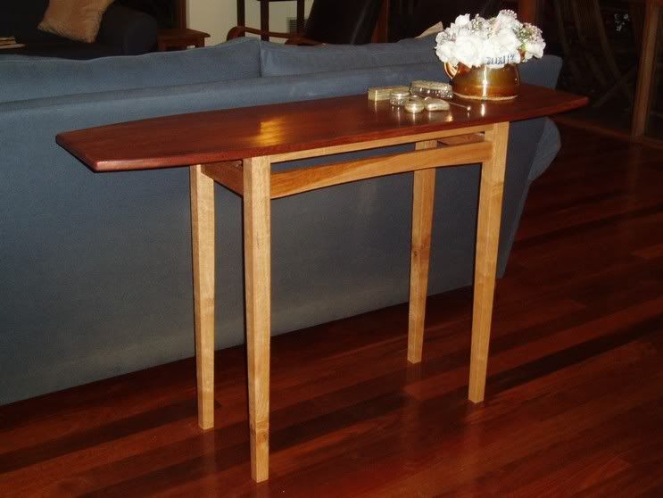

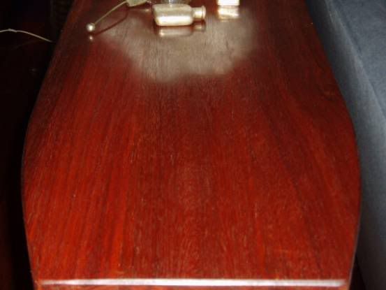

The only reason I used the Veritas BUJ so extensively was as a challenge to myself. It was a bit of fun. So I did all the dimensioning, from rough to ready, as well as the final smoothing with the one plane. But I would not advise this on a general level. I prefer a short plane as a smoother - it is more efficient (removes less of the thickness to smooth the surface). For large, flat surfaces the BUJ is very capable of producing a finish as good as any dedicated smoother. This is not simply because it has an adjustable mouth, but the blade is thick (3/16"), well bedded, and you can set it up at any cutting angle you prefer.
This is what I built. The other "plane" was a spokeshave (I stopped short of trying to plane an inside curve with the BUJ!).
Jarrah and Blackbutt from the salvage yard:
The top was three boards. I enjoyed using the BUJ for jointing.
I get a great deal of pleasure from working jarrah. Not only does it look good, it has such good properties for almost any application.I
wish I was closer to the source.The table looks rich.Lapun in Brissie.
