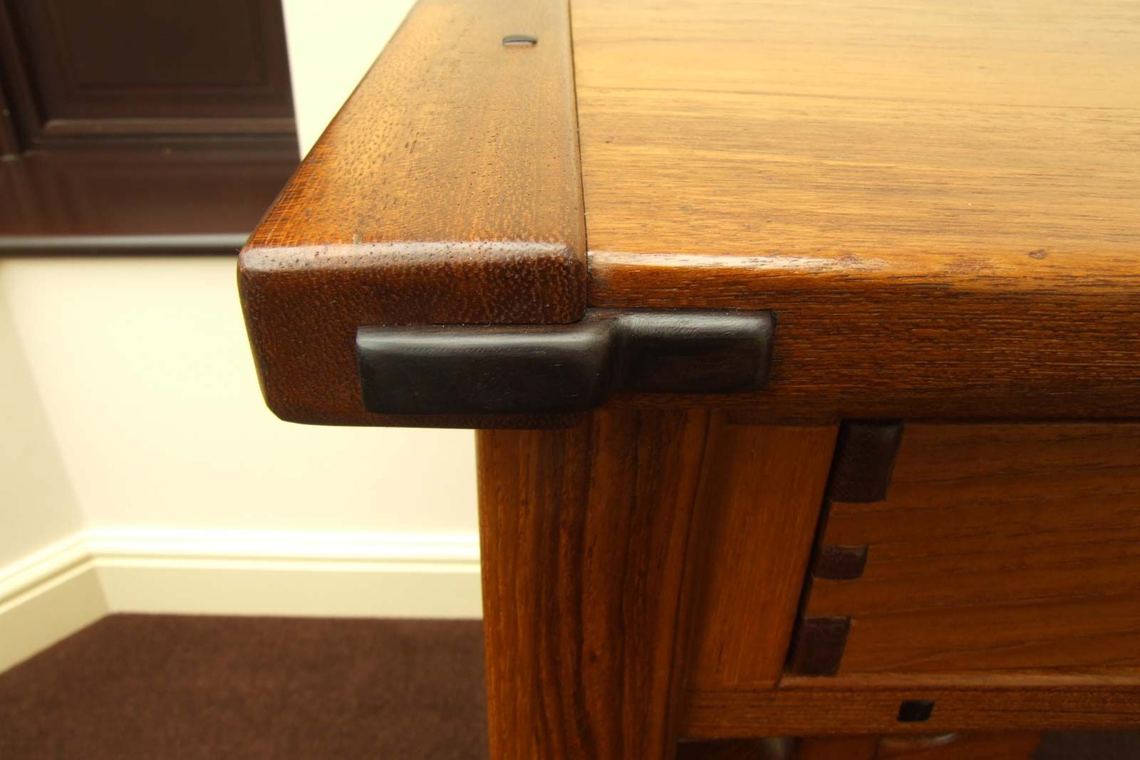

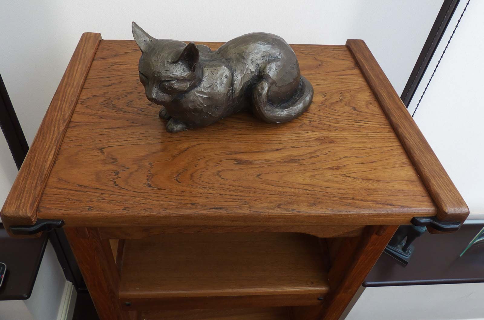

The desk breadboard ends are also raised above the height of the desktop main surface, in the Greene & Greene style. This style has many pieces of furniture in which such raised breadboards ends are used.
https://d4c5gb8slvq7w.cloudfront.net/eyJlZGl0cyI6eyJyZXNpemUiOnsid2lkdGgiOjE2MDB9fSwiYnVja2V0IjoiZmluZXdvb2R3b3JraW5nLnMzLnRhdW50b25jbG91ZC5jb20iLCJrZXkiOiJhcHBcL3VwbG9hZHNcLzIwMjFcLzAzXC8yOTE0MTYzNVwvR3JlZW5lLUdyZWVuZS1zbWFsbC1ib29rY2FzZS01LmpwZyJ9
https://d4c5gb8slvq7w.cloudfront.net/eyJlZGl0cyI6eyJyZXNpemUiOnsid2lkdGgiOjE2MDB9fSwiYnVja2V0IjoiZmluZXdvb2R3b3JraW5nLnMzLnRhdW50b25jbG91ZC5jb20iLCJrZXkiOiJhcHBcL3VwbG9hZHNcLzIwMjFcLzAzXC8yNzEwMTA1NFwvR3JlZW5lLUdyZWVuZS1kZXNrLTEuanBnIn0=
