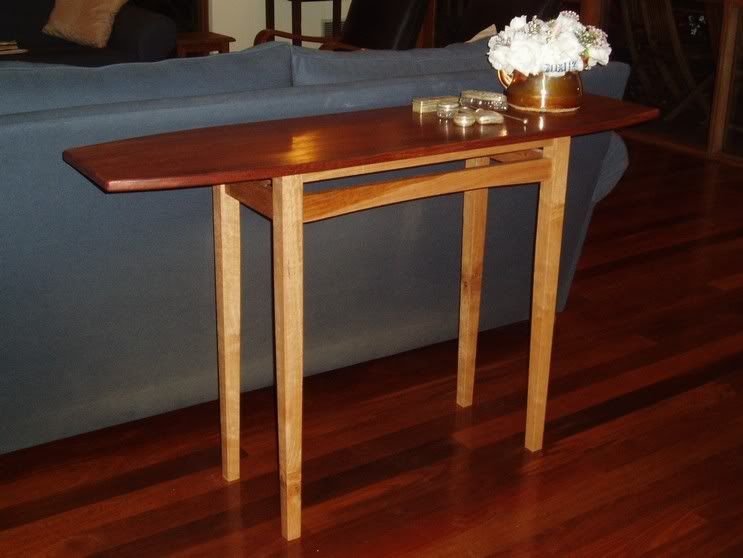

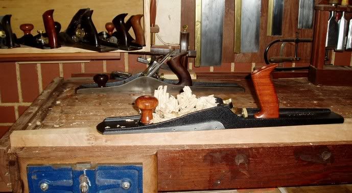

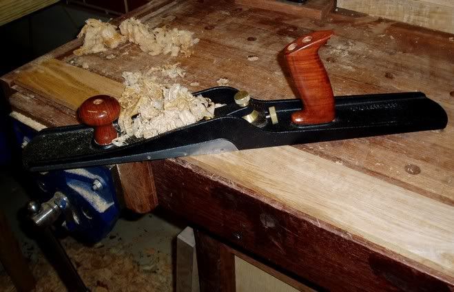

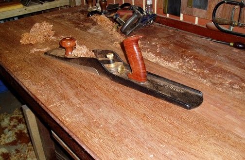

I was thinking about these issues as I stood working in my workshop surrounded by a million handtools, wondering if I and the world had been on the receiving end of a giant woodworking hoax - the hoax being that one needs any planes beyond a #6,. Has this been a sales gimick just to get me/us to buy all on my shelves and on the shelves and workbenches of millions around the world. No, I'm not being sarcastic - this is a genuine question. Of course we know the answer, so the real question is "why is there such a difference in the position you suggest and the one I (and others) follow?" Again, not sarcasm, but a genuine question.
I think that there is an answer, and it is that we may be viewing the process of cabinetmaking from two (different) vantages. Using longer planes, such as a #6 (or, as David Charlesworth prefers, a #5 1/2), is workable if this is simply at the tail end of a sequence that begins and involves machinery in the main. If all you are doing is working with flat timber, then the length is not a big issue. The fact that a #6 is cumbersome for most tasks, such as smoothing and trimming end grain, is glossed over.
Do I know what it is like to work this way? Why, yes I do. I have (as a dare) built an entire table using a jointer and a spokeshave (the latter was used for curves - even a jointer has a limitation!). All endgrain, bevelling and smoothing was done with the jointer.
Flattening with the LV BU Jointer:
Smoothing with the LV BU Jointer:
Planing tapers:
Finished Jarrah and Blackbutt table:
But I would not consider this an efficient way to work. I would also not expect a professional cabinetmaker to keep re-setting the one #6 he owns. I would expect that he just reaches over and picks up his smoother, block plane, jointer, etc as is needed. Of course this assumes that he is working predominently with handtools, or that handtools figure prominently in his finishing process. If this cabinetmaker used a #6 to fine tune work that is predominantly done on machines, then advocating a #6 is inappropriate in these discussions.
So, yes it can be done, but this philosophy does not fit in with the way I view cabinetmaking.

Re: the plane being used only with machine work: Yes, this is indeed the case these days.
However, If all you are doing is working with flat timber, then the length is not a big issue. The fact that a #6 is cumbersome for most tasks, such as smoothing and trimming end grain, is glossed over. If you used an 18" plane to flatten a board, then a similarly sized plane would be able to finish the job with ease.
I haven't got a reference text of work methods in the late part of the 19th century or earlier, so I'll defer to those that do.
Re: your statement that: "[you] would not consider [working with a single plane] an efficient way to work. I would also not expect a professional cabinetmaker to keep re-setting the one #6 he owns. I would expect that he just reaches over and picks up his smoother, block plane, jointer, etc as is needed. Of course this assumes that he is working predominently with handtools, or that handtools figure prominently in his finishing process.
It's a trivial matter to wind the blade in or out of a plane - the rest wouldn't change.
Do you think that you'd have done things much quicker with multiple planes on hand compared to using the one, given that most of the lines are straight?
I'd still state that the efficient way to work is to have the minimal number of tools on hand and in-use.
If I were to build the table by hand, I'd be using the longer plane for most tasks. The curved edges would be cut with a bowsaw/spokeshave if I couldn't use the bandsaw to rough them out. If sandpaper was out of the equation, then it'd either be a card scraper or a smoother to take the tracks of the try plane out of the surface. The lines of the taper on the leg make it ideal for a long, wide plane.
