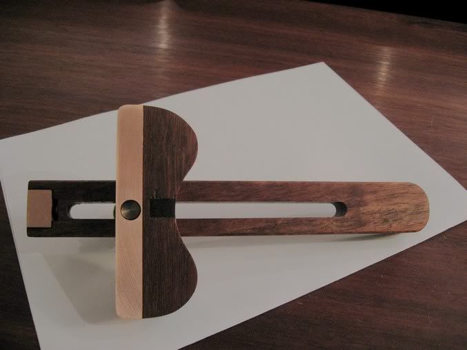

This design is taken from a Woodjoy gauge I have admired. I guess imitation is a sincere form of flattery.
I made all the parts with the exception of the Veritas knob. The blade is an ex-spadebit, V-edged so that it can cut in either direction.
The construction is brass (unusually pink), Tasmanian Blackwood (top) and Jarrah (in fence).
The fence is reversable to mark curved edges. The face is 3″.
Thanks for looking

Definitely not! I am living proof that anyone can turn out a one-off if they persevere. I will leave it to the pros to make more than one.
A beautiful piece of design and execution! Design is a very difficult thing to teach and to learn. After seeing your cutting gauge, there is no doubt in my mind that a cutting gauge would be an excellent task for a woodworking design class. I love the old saying:

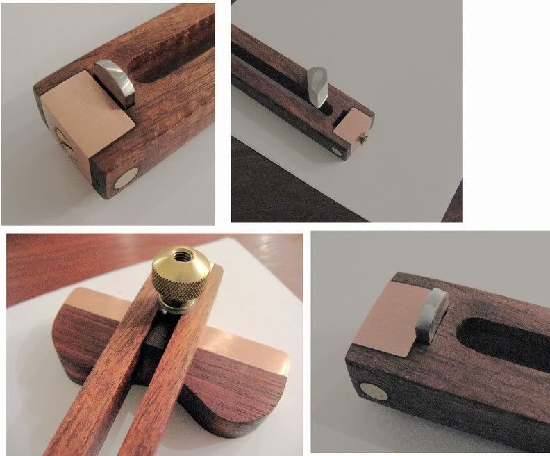

I have a few questions about the screw that holds the knife in place. Is that a "set screw"? in other words, is it a threaded cylinder without a conical head? Also, is the other end of the screw flattened out a bit for pressing onto the knife? Did you tap the wood for the screw, or just screw it in? I am sure these are "naive" questions, but what the heck. I'll learn faster if I ask. Also, where is a handy place to look for a piece of metal that can be ground into a knife the size of the one you made?

Thanks for the kind words but I must emphasize that the design is Woodjoy's, not mine. I only adapted it here-and-there for my own needs.
The knife is secured by a brass machine screw from the front end of the arm. You can just see this in one of the pictures below. The other end of the screw is filed flat. Further, the knife is also held within a mortice so that there can be no sideways movement. Incidemntally, since the picture was taken I have lowered the angle of the V so that there is a greater slicing action from the blade. The higher angle tends to tear a little.
I shaped the brass end, cut and fitted it to the arm flush to the end of the mortice, then removed this to cut the mortice for the knife. After a dry fit I epoxied the brass end, pinned it with brass rod (1/3 of the way in from each side - not all the way through), and drilled and tapped the thread for the knife-holding screw.
The other feature is the tenon that keeps the fence square to the sliding arm. This can just be seen at the rear of the knob.
