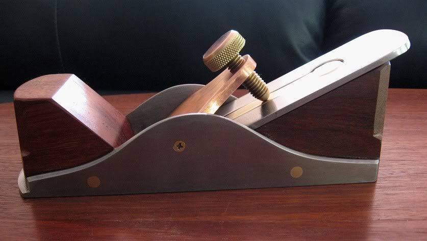

Wow, you really have put a lot of effort into prototypes. Two suggestions:
Firstly, consider a 25 degree bed (rather than a 20 degree bed). If this is to be a smoother, then you are unlikely to want less than a 50 degree angle of attack. Probably, you will be looking at a 60 degree cutting angle. The extra 5 degrees you save on the bevel will extend the planning life. And a 35 degree bevel is easier to hone freehand than a 40 degree bevel.
Secondly, why not make a real, working model. Either of wood or of iron – use a Stanley #4, as I did, to test it all out. This one is BU and has a 25 degree bed. It is a superb user.
Hi Metod, yes I can see what you are shooting for. I still think that the usual knob and handle a la Stanley takes a lot of beating, but I keep trying other "designs". Are you sure that there is sufficient room between your thumb and the mouth at the for shavings clearance?
I am tempted to make a plane that has a knob in front and the same at the rear-may look strange but still well grippable....May be appropriate for a block plane type or shoulder plane.
I see that Derek is advocating a bed angle of 25 degrees rather than 20- I think it better to stick to 20, the main reason being that these bevel ups become hard to push with greater angles, requiring more plane mass.
