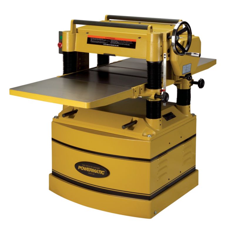

Good info in your post. I have the PM 209HH and have no complaints for what little I have used it. My question - would I benefit by raising the wings as you described for the other planer?
Tink
The recommendation to raise the wings, along with my other suggestions, applies to any of the bench top planers.John White

Thanks, as I mentioned, I have the floor model PM 209 that I have not used much and although I haven't noticed snipe, I had wondered if lifting the wings would further help.
Edited 11/10/2009 11:29 pm ET by Tinkerer3
John, I don't think Tink's planer qualifies as lunchbox....
...unless he's Godzilla....
forestgirl -- you can take the girl out of the forest, but you can't take the forest out of the girl ;-)
Edited 11/10/2009 11:19 pm by forestgirl
