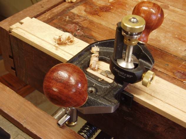

Not trying to stir the pot, but the veritas router plane actually does a terrific job on dadoes. I recently built a standing cabinet style jewelry box for my daughter as her graduation present. (She just got her Master's degree in accounting, and I'm a proud papa!!!!) Because of her fantastic effort in college (4.0 for 6 years, another gloat!) I wanted to give her something made with just hand tools, as an analogy to what one can accomplish when one sets one mind to it. Since I didn't have a plow/plough plane, I decided to use my router plane. I practiced on a piece of scrap first, and discovered that with the grain AND across the grain, the router plane did an excellent job. I was even able to freehand a 1/2" dado down the center of a board too far away from the edge to use the fence. I know that's not what the tool is designed for, but it accomplished the mission with astonishing accuracy and speed.

You're not stirring the pot, you're providing data we need;When grooving, how do you handle the blade depth issue?
When dadoing (if that's a word) did you knife out the walls? saw them? does this tool have nickers i don't know about? Would you recommend this tool for this task?Adam

For both applications, along the grain and across the grain, I had no issues with tearout in cherry. I took the time to hone the cutter to a fine polished edge, which didn't take long as Lee Valley really prepares their blades well. I was actually able to follow my marking lines across the grain freehand without a fence. The little fence that comes with the router plane is only for working very close to the edge. Once I got the cut going with the initial pass, I found that the cutter followed the previous pass very well. Once I got down about 1/32" or so, it followed the side walls so well I hardly had to pay attention. It was much easier than I thought it would be. Also, the center dado I created was stopped about 1" front the edge, and by using the square faced cutter, I was able to cut right to with a wisp of my line, and break off the shaving. Each successive shaving would break off a little bit further back into the dado, so by the time I was finished, I had about 1/8" to clean up with a chisel.
As far as cutter advancement, after each pass, I just gave the adjuster a good twist. I was never able to set the cutter too deep to cause a problem, and the dadoes and grooves (I always just call them dadoe's regardless of grain direction, although I know that is not gramatically correct). I was working on 1/2" stock, so my dadoe's were only 3/16" deep, but it went better and quicker than expected. I would say that by the time I would have had a tailed router and fence setup, I was already finished doing it by hand. I was quite impressed with my new tool.

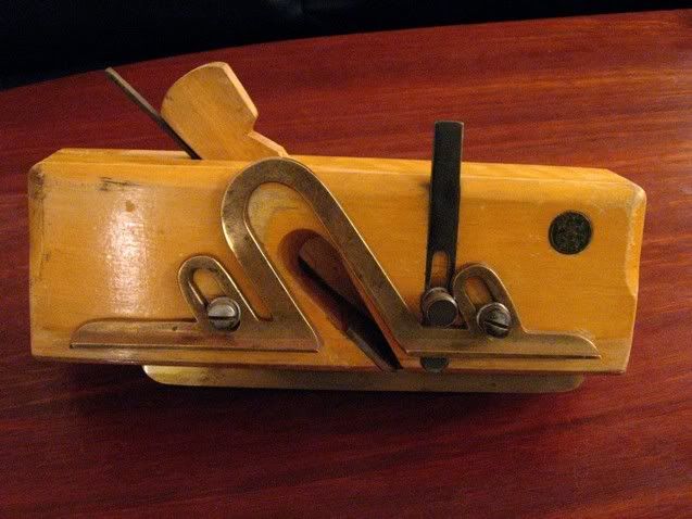

Here's a photo of 26 (yep that's right, 26) dados cut with a Stanley 39 3/8 dado plane. It's for an apothecary cabinet-style chest of drawers. The sides of the dados were defined with a tenon saw. The dados are 3/4 inch wide. I'd like to refute one of Lataxe's points that the dado plane had to be the same size as the dado. The 39 3/8 works great on 3/4 inch dados - just do one side and then the other. The depth stop works to stop depth regardless of which side you are working on. All in all the 39 3/8 is a great plane.
Just goes to show, once again, that you can easily cram one hour of work with an electric router into a day and a half's work with hand tools (a dado plane and a saw).

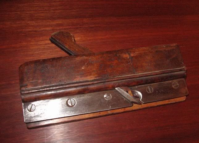

Adam is correct--pick yourself up a few sizes of wood dado planes from eBay or an old tool seller. Would help to ask the school what size of dadoes will be created--else get a few sizes. Alternately, you can spend big bucks on the great and wonderul Stanley #46--just make sure it has all the pieces.
A side rabbet plane is useful if you get wooden dado planes. That way you can use the dado plane undersized closest to the size needed and then us the side rabbet to widen it out.
There are several side rabbet planes to choose from. The #79 is probably the easiest and cheapest to get a vintage version of. For new, the #98/99 pair from Lie-Nielsen work great. But there are wood versions of these, too.
For stopped dadoes, I use a brace and bit sized for the dado and drill out the stopped end and saw the shoulders. Pop out the wood with a chisel and clean up with a router plane.
You can cut dadoes with a plow plane, but they are not the greatest at it. If you do use a plow plane, it helps to obtain a clean shoulder to knife the dado's shoulders prior to plowing.
Take care, Mike

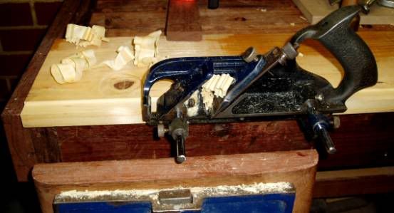

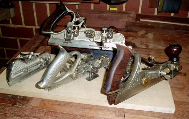

Here is mine:
There are certainly a lot of options when it comes to plough plane variants.
I like experimenting with planes and own several ploughs, including an #043, #044, #45, and #46 (the latter designed for dados). For simple grooves with the grain I grab the #044. All of these planes may be used to dado as well, but then work best if you first knife the outer lines.

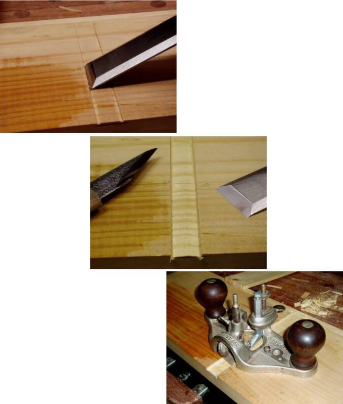

The LV router plane can do a good job of ploughing a groove as well, because the depth adjustment is easy to use (with reference to Adam's comment - I agree that this is a difficult task if one uses the Stanley). This plane comes into its own for stopped grooves.
With dados, my preference remains to knife the lines and chisel them out. Then clean up with a router plane. This is a surprisingly quick process.
Lastly, for rebates (with the grain) the Record #778 is preferred over the Stanley #78. It works fast with a largish mouth. I added a LN blade, which is a little thicker than the original.
... and for fillesters (across the grain) I have a ECE with a skew blade.
And here ends the illustration!

* Various old wooden ones - often cheap even from tool dealers; but all look suspiciously "tired" and one wonders how easy it would be to, for instance, align the worn nickers with the worn blade.
* Stanley No 39s in various widths - rather expensive for items that often look knackerd, although I imagine they are do-upable by those so inclined and able - assuming you can find and purchase one without getting a pig in a poke. Where would one find a replacement nicker or blade, for instance?
* There is also a Stanley 239, as illustrated in the Gareth Hack book; but I can't find one of these for sale and it is probably expensive because rare.
* A Stanley No 46 combination, which has skew blades as well as the nickers. As with all combination planes, these items have the reputation of being hard to set up and use, despite their apparent versatility. I can't find one for sale but the guide price is "a lot".
* A small number of newly-made wooden dado planes (eg Knight); but many woodie manufacturers seem to make every variety of weird plane except dado planes.
* I can discover no modern manufacturer of metal dado planes - not even Lie Nielsen, Veritas or Bridge City.
All this leads me to wonder - why are dado planes the forgotten plane, especially within the metal manufactories of ie Lie Nielsen and Veritas? Is there something inherently difficult about their design? Are they somehow made redundant by some other plane?
If I want a new one, will it have to be wooden?
