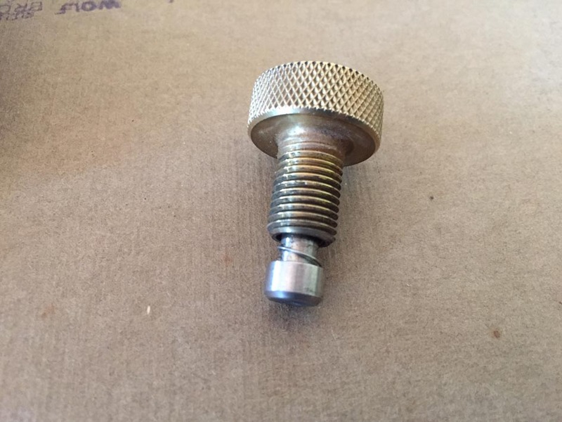

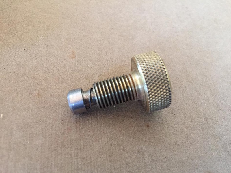

You guys with the Veritas, is there a wavy washer or anything under the locking screw?
No matter how tight I turn it, the iron has some wiggle not enough to really matter until you hit or ride along the edge of a dado.
From day one, I’ve had this feeling something wasn’t quite right. It definitely does not lock down like the 71.
Robert, the issue with a loose iron is possibly due to the spring in the collet being dirty. I've never had this happen to me, some have so I will accept this. I have been using the Veritas from pre-production times (!).
Okay, this is the screw in the collet ..
https://i.postimg.cc/FH60HKRW/Router-spring3-zpsppx7gdt6.jpg
And this is the spring in the screw ...
https://i.postimg.cc/7Ymgj9yy/Router-spring1-zpsyd2ph7rh.jpg
https://i.postimg.cc/Jz0b8X1H/Router-spring2-zpsiha9zwvz.jpg
Solution: clean and oil it. Done.

I did check that, functions normally.
I have to crank it down very, very tightly to prevent the iron from wiggling. You can even see the collar move.
I am relatively strong, not physically impaired in my hands, but I have to tighten it much, much harder than I feel I should have to.
I got my Stanley out just to compare and there is no doubt the iron is much more solid with much less force on the screw.
I'm going to see if I can replace the knurled knob with a thumb screw like the Stanley.
I don't understand why I'm having this issue, I'm not doing anything wrong, its just a matter of tightening a screw!
Contact Lee Valley. They will sort it out for you.
I apologize if I missed this somewhere in the thread . . . have you removed the iron and super cleaned everything? Iron, seat, retainer. Naphtha or alcohol, leaving the surfaces dry, dry, dry and clean.
