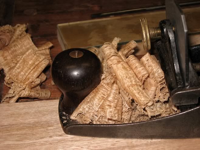

To give you an idea of what you might aim for with the scraper insert as a scraper plane, here is a picture of my Stanley #112 on Tasmanian Oak (long grained wood) ...
On Jarrah, which is short grained, the shavings change - become shorter. The following picture included the #112 plus my Stanley #4 1/2 with a blade ground to 45 degrees and reversed (creating a 90 degree scraper plane) ...
