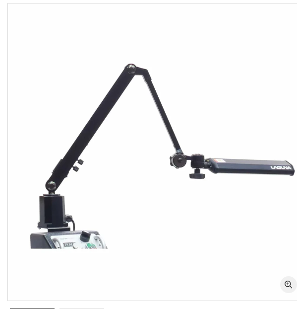

I recently found a solution I like more than rechargeable LED task lights.
This Laguna lathe light has temperature and brightness adjustments on dials and a power switch.
It's corded, which I like; no more recharging batteries.
It's a screw mount only, but I epoxied four powerful magnets into the base and put a nonslip material on the bottom.
I can easily move this thing anywhere on my table saw, and the direct light is so much better than anything I've used or seen.
They only cost a little more than my small rechargeables.
I will buy at least two more to station around other machines.
I know you want overhead, but I wanted to mention it.
It's my favorite purchase recently.
