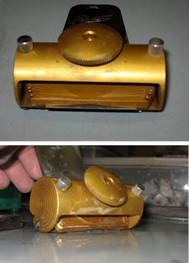

The Sharp Skate is a recent addition to the range of blade honing guides on the market. Designed by Harrelson Stanley, it is different in concept to anything else I have seen to date. There is no doubt that in discussing its pros and cons it is capable of polarizing woodworkers. It will raise a number of questions for those who are curious about how blades are best sharpened. It is definitely better suited to a certain type of hand tool user than another and, consequently, woodworkers will need to ask of themselves “who am I and what do I want from the Sharp Skate?” Lastly, regular users of other types of honing guides are likely to experience an initial frustration with the Sharp Skate. This is not a criticism but a part of the journey.
If this all sounds rather intriguing, then read on …

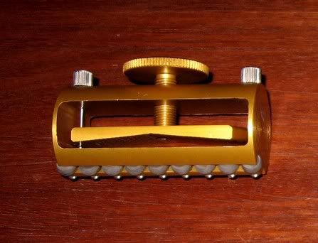

The Sharp Skate

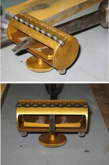

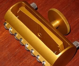

The Sharp Skate is built from anodized aluminium. It has a large screw head that adjusts the blade hold down. The underside has 9 small wheels along which the Sharp Skate runs. Unlike traditional honing guides that move fore-and-aft, the Sharp Skate moves side-to-side.
Another original solution is the way a blade is secured, either in square or skew mode. A frequent complaint of many guides is how a blade may slip out of a setting. Here, the underside of the hold down is both angled and ridged. The angle allows pressure to be placed across an uneven blade back, while the ridges create a multitude of fences against which the blade is aligned.

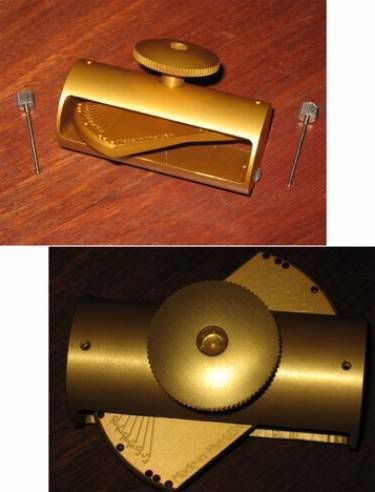

At each side of the guide is a thin steel rod. When removed the hold down is able to pivot, and specific angles may be selected to sharpen skew bevels faces. There are preset settings for 20 through 45 degrees.

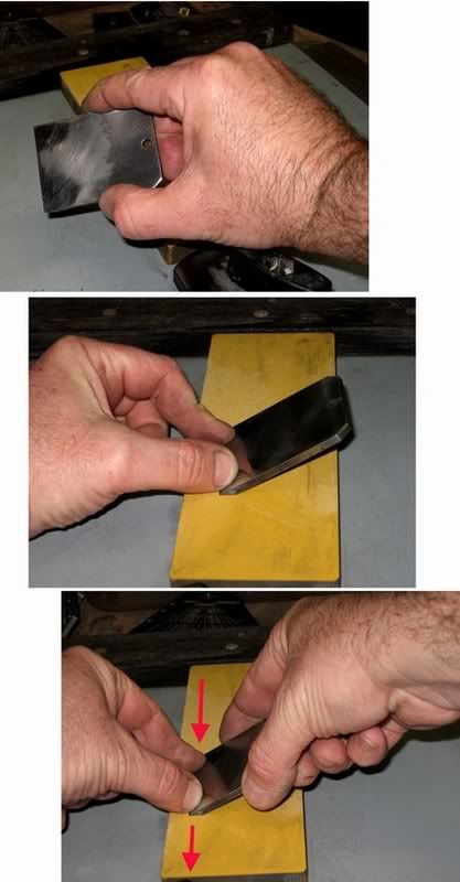

· The right hand (for a right-handed individual) is used to support the blade. Do so by holding it by the fingertips. “Take the power out of your right hand”.
· The left hand is used to sharpen. Used it like a saw… “as if the left hand is going to saw the stone into ribbons…trying to keep the hand rigid from tips of the fingers to the elbow”.
I noticed that my natural inclination is to tuck the remaining fingers of my right hand under the blade. This served to take more of the weight off the left hand, which is doing all the work – pressing down the bevel face and sliding it back-and-forth.
The advantage of this freehand method is the greater degree of face support. Compare this to the traditional front-back method where the bevel face will want to roll.
· Rock the blade until it is flat on the surface.
· Use short strokes to the end of the stone to maintain registration (the temptation is to immediately take long strokes, ala a traditional guide.

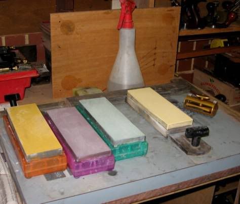

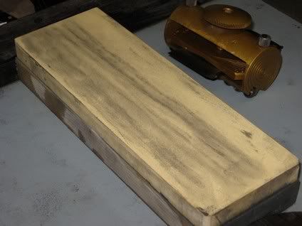

The media used was a set of Shapton waterstones comprising 1000/5000/8000/12000 grit. These were maintained with a 10” DMT Extra Coarse diamond stone.

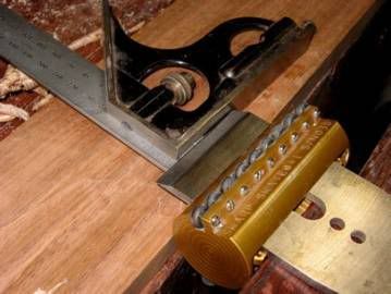

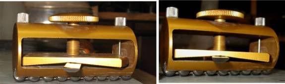

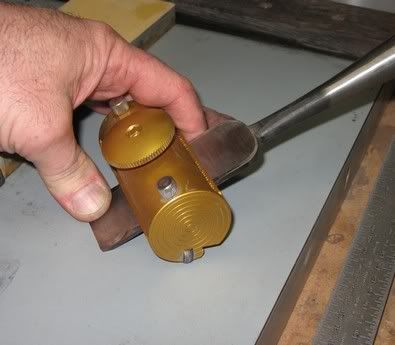

Slide the blade in and tighten the blade until just snug. “Snug” means that the blade is still capable of being moved fore-and-aft, but not sideways.
Make sure that the blade is centered and against one of the guide walls.
Raise the blade until it makes contact with the flat surface, and slide it down until the wheels are touching.
Once this is done, you can tighten it all up. Finger pressure is enough. The YouTube video shows Harrelson using a Hex key, but this is unnecessary.

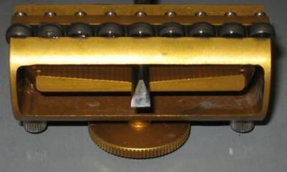

The hold down has sufficient adjustment to secure tapered blades as well. Here it is holding securely a ¼” Oval Bolstered Mortice Chisel, which is a stern test for any system.
A word of warning. The Side Skate is no less vulnerable than other honing guides to blades being skewed to one side. With some guides too much pressure (down force) to one side of the blade will skew it in that direction. In the case of the Side Skate, unless the blade is centered, the hold down angle will do the same thing. This is illustrated in the picture below:
Once centered, the Sharp Skate is capable of securely holding very narrow blades, down to a 1/16” chisel I tried. Here it is holding a ¼” dovetail chisel …
Setting up a narrow chisel blade is very fiddly. While these may be held quite securely, getting them square is a delicate job, that ends up being redone a few times, and requires several lagers to maintain one’s emotional equilibrium!
Wider plane blades are reasonably easy to set up. I suspect that the ease of securing a blade in the Sharp Skate is proportional to one’s experience in freehand honing. It is necessary to have a feel for placing the blade flat on the surface. This requires rocking it slightly back-and-forth until it is just right. This process is a familiar one for anyone used to freehand sharpening a blade, whether front-to-back or side-to-side. These users will show greater tolerance.

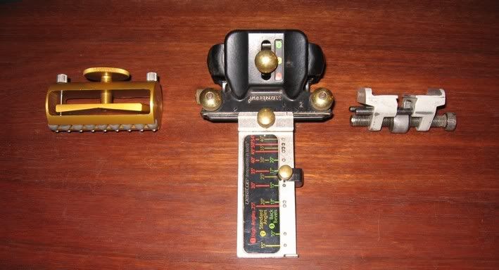

Users of other makes of honing guides, such as the Veritas Honing Guide Mk II or the Eclipse, will no doubt experience this process as extremely frustrating as they are used to installing the blade and clamping it down with minimal fuss. What would make the effort worthwhile?
In my opinion, the Skate Sharp is a honing guide for the would-be freehander. It might also be considered to be “Training Wheels”. As I shall demonstrate, it does a good job of honing, but it relies a great deal on the attitude of the freehander, this being an acceptance that precision is less important that a sense of being hands-on.

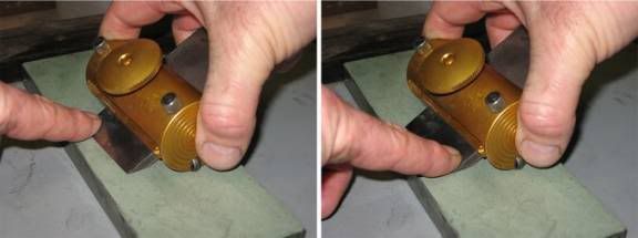

Gripping the Sharp Skate

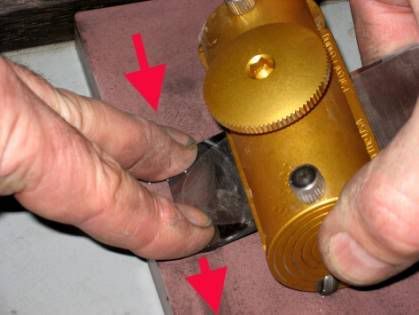

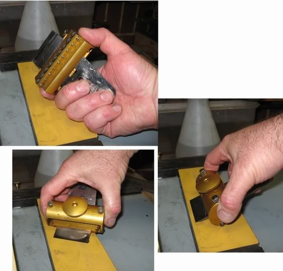

The way one will hold the Sharp Skate is an extension of the way one holds a blade for side sharpening.
As before, the right hand supports the blade – and guide – while the left hand guides the bevel across the stone.
Above is the right hand placement.
Below is the left hand steering the blade across the stone.

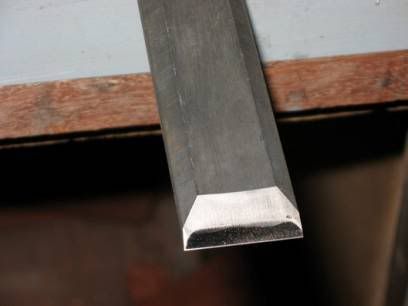

Below is a honed straight bevel.

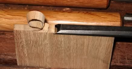

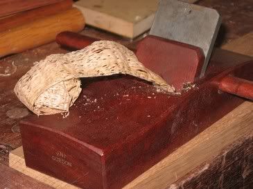

…. And here is the result paring Paulownia end grain. A clean slice on this soft timber is only possible with the sharpest of blades.

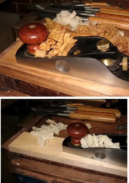

Here is a picture of the HNT Gordon producing a nice cambered full width shaving:
A few more plane shavings ….

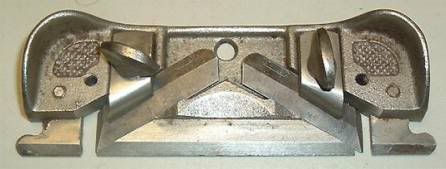

Here is the Veritas complete with accessories (skew jig, camber roller, and protractor):

Aaah Philip! You read my mind! I think that the wheels here are the limiting factor for two reasons: firstly, they are bloody expensive. A mate of mine, who is an engineer, took one look and said of the wheels and, especially, the screws "Big Bucks". This is probably the reason why the guide is so expensive. Secondly, the wheels are (as I mentioned in the body) quite directional, and this prevents diagonal movement. So I also got to thinking about a roller ball. The problem with that is that grit will get inside and create wear. So I have another idea (not that I need this, but what the hell, my curiosity is up..)
I am thinking of getting out my old Veritas guide Mk I (not the Mk II) and removing the roller. In its place I will put a rounded sled. The sled can be made out of HCS, and then I will heat treat it so that it is harder than hard (i.e. heat it red hot and then just dunk it in oil). The steel will be brittle but this is unlikely to be put to the test. The hardness of the steel should resist wear on a waterstone (or will it?)
Watdoyouthink?
Even the hardened steel will be rapidly worn, I believe, because of pressure (force over small area).
I would think steel balls would be cheaper to do than the wheels, and I don't believe the grit /wear would be any inhibiting factor- certainly no more so than on the rollers of Eclipse types and others. My Eclipse is close to 40years old now-wheel is a bit loose but still works well enough.
The trouble with that guide is the price, when compared with others out there which are more versatile, so I feel H would do well to find other ways to make it more versatile.Philip Marcou
Castors come to mind.
I think balls and sled will wear, and fear costs will be even higher.....

I do side honing by clamping the blade in a vice or to the bench and nipping the bevel and a hand hone between forefinger and thumb. A few side to side passes and a little deft angled pass to suggest a secondary bevel (if I feel like it) gets the job done. No stones jigs or do-das.

I can't get over, however, how large and unwieldy the Harrelson think looks!
Hi Tony
The Sharp Skate is actually quite compact. Here it is with the Veritas Mk II and the Eclipse.

Balls have been tried before--for free rotation they require a socket. Not good for the crap they pick up off the stones. Engineering to remove the effect of slurry? Perhaps.
I think it may be a bad idea to have something sliding on a stone that is harder than the stones themselves. Would ceramic fall into this category? I don't know for certain. If so, it would simply wear the stone.

The old Record 151 jig had a single, large ball and this made it really versatile (forward/backwards, sideways, figure eights, whatever you wanted to do). I have one that works very well, but I keep the gunk blown off the ball bearing with WD-40 on a frequent basis.

While I use a LV jig when needed, my favorite is the Millers Fall #240:
It should look familiar to anyone who has seen the original LV honing guide. But this one is also micro-adjustable via a better (though less precisely repeatable) mechanism. Allows for lightly cambered blades--but doesn't do side sharpening. But as I mostly hone by hand, oh well!

On the other hand, I do believe that freehand side sharpening has a future. It is quite widely used in Japan yet, with the exception of Harrelson's DVD, it has had no publicity in the West that I can find. This afternoon I honed a cambered profile on a thin Stanley blade (for a #5 1/2). With a hollow grind to balance on, side sharpening made the process surprisingly easy.

I too have been using a long-edge motion for what seems forever. Don't know why, really. I probably read or saw it done by someone in times past. And it may be because of honing other larger edge tools that way, whether the tool across the stone or the stone across the tool. Perhaps it is because of my early carving exposure (sharpening out cannel gouges) or honing turning tools.
