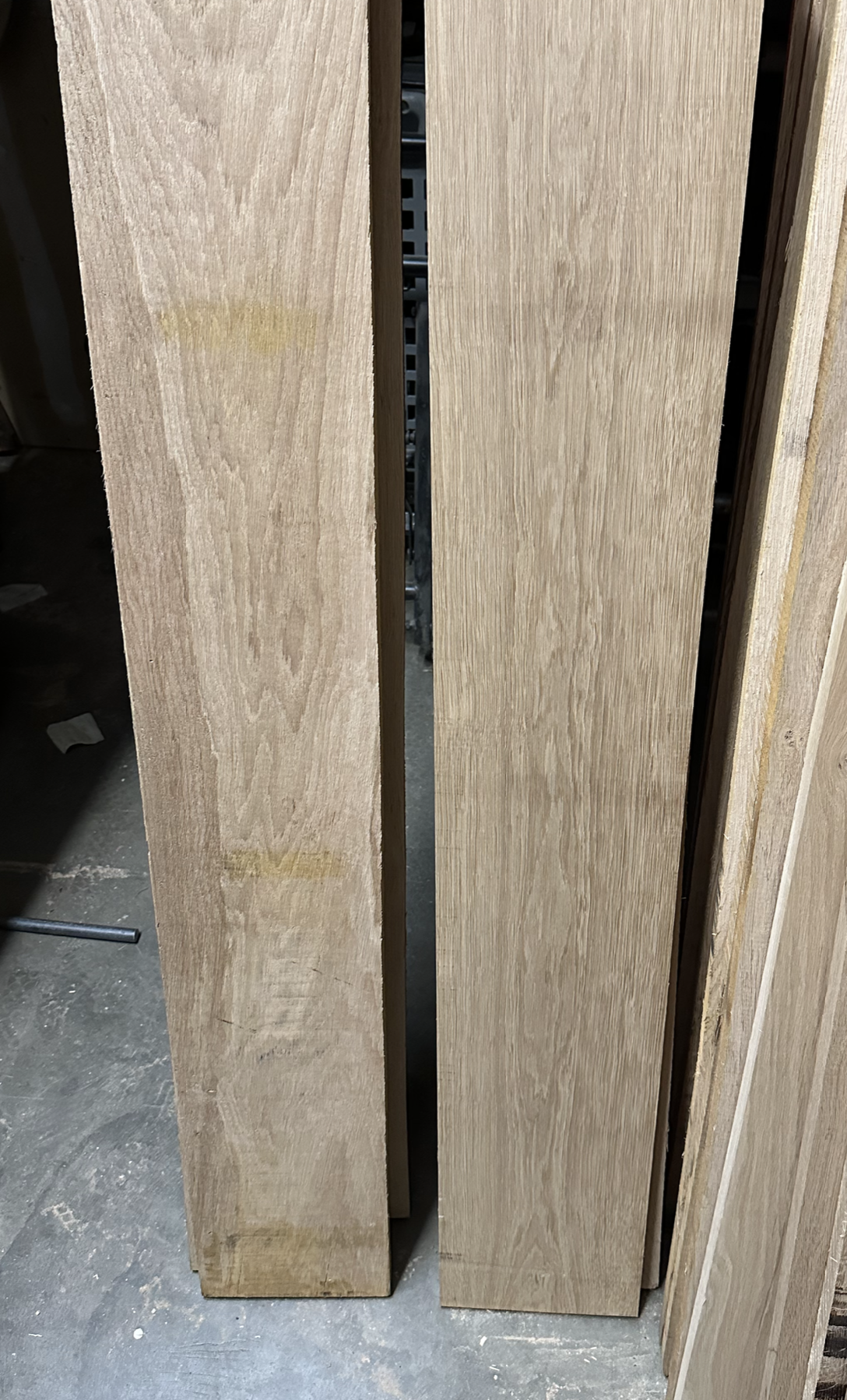

In the recent years we have been having a growing problem with “banding” stain marks on our white oak lumber from our supplier. Typically they are dark lines about 1-1/2″ wide and are spaced a few feet apart perpendicular to the board (see photo). These stains go through the entire board making the boards useless. This most recent batch of lumber has the banding marks but is yellow instead of the darker color (also see in photo). Any ideas on what is the cause? I’m thinking it must have something to do with drying or storage process. Any thoughts would be helpful because this is becoming expensive (and time consuming). Sometimes our suppliers will return the wood and sometimes they wont.
Surface stains like that could probably be removed by oxalic acid. I'm amazed that banding would cause stains to go all the way through the board. As an experiment, try resawing a piece that has this stain to expose the interior of the stain and try using oxalic acid on that. If it works, leave it for a while to see if it returns.
That would be sticker stain. That will happen sometimes in the kilning process. Typically it would be considered a defect if the amount is extreme. It will happen in any specie if the kiln schedule is not correct.

It’s directly related to the drying process , more precisely to the stickers that are used to space the wood in the kiln. I cannot tell you exactly what the staining process is all about but that is something that should be fixed by the kiln operator , it’s called sticker stain.

Definitely sticker stain. Typically, this is from using green stickers instead of dry, and leaving the stack out in the weather to air dry before kiln drying, where rain can re-wet the area trapped between the board and the sticker. It is indeed caused by mold and fungus, and there are different ones that discolor the wood in different colors. I have usually been able to plane a bit of the surface off and get rid of it, but it does depend on how deep it goes, which can vary a lot.

Sticker stain. You can try oxalic acid, but I don't know if it will work. Beyond that, it's not fixable.
Wet stickers. I had some white pine cut and air dried. The stickers extended out past the pile into the screen that was over the stack. The stickers in the top 2 layers were re-wet with every rain. The stains went deep.

It's sticker stain. Sticker stain is oxidative, not biological (not fungal).
Using old logs is a factor, meaning a long time between harvest and kiln drying. Chemical reactions occur during log and green lumber storage, especially in warm weather.
Drying too slowly encourages sticker stain. As someone mentioned, wet stickers also encourage stain. Restacking on dry stickers in slightly different locations after a week can help reduce the issue. Narrow stickers help. Some manufacturers use grooved or slotted stickers the get additional drying under the sticker. The conditions for sticker stain are established when the wood is green, but high temperatures as the wood gets dry can encourage the chemicals to react and darken. This is why lighter-colored hardwoods are often limited to 160F whereas 180F is used for other hardwoods.
