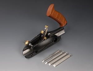

Veritas recently launched their Small Plow Plane onto the market. It has been eagerly anticipated by many, partly because Veritas may be counted on to produce an innovative product, and partly because there has not been a new metal plough of quality built since Record ended production of their #044 in 1970. There is some debate whether post-WW2 Stanley planes could be called “quality planes” and, consequently, their “desirability factor” is low. Veritas describe the Small Plow Plane as being similar in design to the #044.

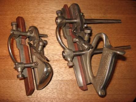

In this assessment and review of the Veritas Small Plow Plane, I have chosen to compare it with the Record #044 and the Rapier #043.
The Rapier #043 is an exact copy of the Record #043.This a small and simple plough that many favour instead of the #044. The #043 has similarly ceased production and, like the #044, is only available on the vintage tools market.

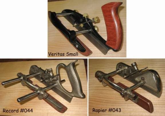

Here are the three plough planes for comparison:

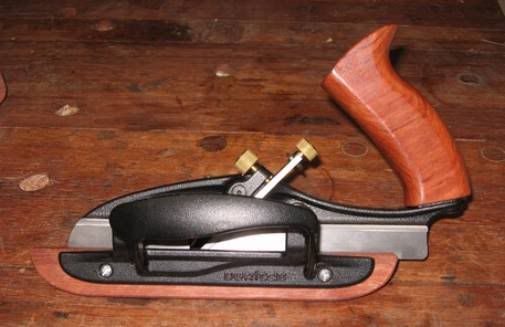

The Veritas Small Plow Plane
From the Veritas Instruction Guide

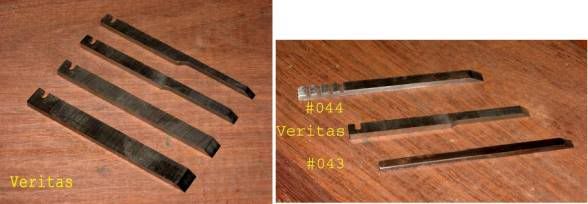

Blades
The Veritas comes standard with one blade, which is ¼” wide. There are four optional blades available that range from 1/8” through 3/8”, either individually or as a set. The blades are constructed from A2 and hollow ground at 35°.
The Record #044 has 8 blades from 1/8” through 9/16”. The #043 has 3 blades 1/8” through ¼”. I assume these are HCS. Not having handled an original set in pristine condition, I cannot say at what angle they have been ground. I hollow grind mine at 30 degrees.
None of the blade sets are interchangeable.
The problem with vintage plough planes is that many lack parts and few come with a full set of blades. My #044 only had the ¼”. I completed the set with modified Stanley #45 blades (by grinding adjustment grooves at the back of each).

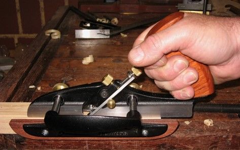

Auxiliary Fence
An auxiliary fence provides better registration against the workpiece.
I had a little fun creating one for the Veritas. There is no rule that says it must have square corners. This one is racy looking, don’t you think? Don’t forget to wax the wood when you use it.

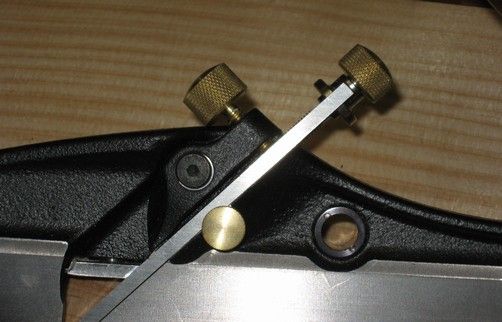

Setting up involves adjustments to the depth stop, the projection of the blade, and alignment of the blade with the outside wall of the skate.

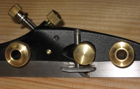

Setting the depth gauge for each of the ploughs was straightforward. Each is adjusted with a knurled knob.
The Veritas Small Plow has a large brass knob that is easiest to use. The mechanism utilizes a wavy washer to provide a spring pressure against the stop when making adjustments. The stop remains in position and is, therefore, able to be adjusted precisely with greater ease (than the #044 and #043, both of which lack this feature). It tightens down securely. One of the nice design features is the chamfered leading and trailing edges, which ensures that it does not catch on an obstacle.
Veritas recommend a depth of cut between .005” – .020” depending on the hardness of the wood.
Veritas Small Plow depth stop

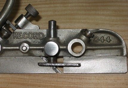

My Record #044 has a depth stop from a Stanley #45, but it is not substantially different from the original, one that resembles the stop on the Rapier #043.
Record #044 with #45 depth stop

Setting up the blade in each of these planes was a telling experience – one that separated the planes in regard to ease of use.
All three planes use a similar system in which the blade is clamped by a lever cap. With both the #044 and #043 this is a loose piece, while the Veritas’ is anchored with a bolt. There is a constant potential risk of the loose lever cap getting lost. In fact, this is such a familiar complaint that Bugbear offers a plan to build a replacement.

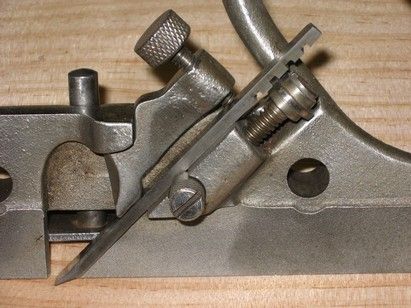

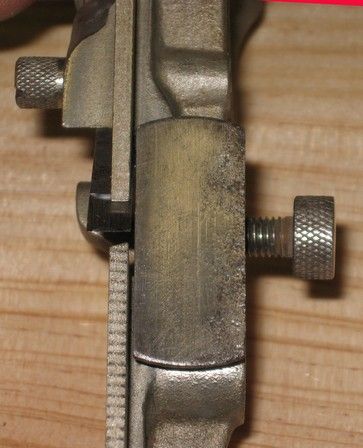

The second point of note is that both the Veritas and the #044 adjust for depth of cut with a screw, while the #043 is adjusted manually. The Veritas’ adjustment is a simple matter of turning a knurled knob while the #043 requires a screwdriver to adjust it in-or-out. It is a big plus for the Veritas over the #044 that a tool is not required to adjust the setting.

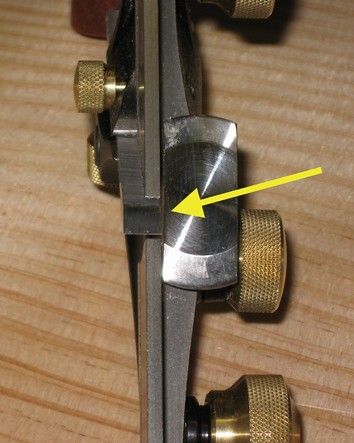

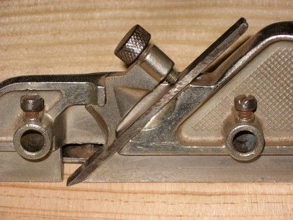

The third issue is that the Veritas is the only one of the three planes where the seated blade aligns with the outside wall of the skate. Both my #044 and #043 can not be aligned simply by popping in the blade and tightening it down (as can the Veritas). The blades of both the #044 and #043 protrude past the skate.
View Image Veritas
View Image #044
To align the blade in both the #044 and the #043 it is necessary to place a straight edge against the side to prevent the blade extending past this point.

One of the first things that struck me about the Veritas’ tote was how attractive it was. I know these things are subjective and individual, but I have criticized the totes on their bevel up planes in the past.
My hand is average in size. The Veritas tote offers a reasonably comfortable grip for myself, but it is a tight fit if used with 4 fingers and is, therefore, a little smaller than I would have preferred. There is more room if used with 3 fingers. There is not a lot of clearance between the fingers and the blade adjustment knob – about the same as with the #044 – but I did not experience any issues here.
Veritas in 4-finger mode

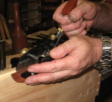

There are differences in the way the supporting hand feels.
The supporting hand applies pressure side-on against the board being planed. A side-and-forward push guides the fence, keeping the plane upright and the cut straight.
The curved section of the Veritas’ fence is 4” long. It was a comfortable fit for my left hand.
View Image Veritas with left hand support

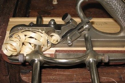

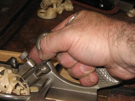

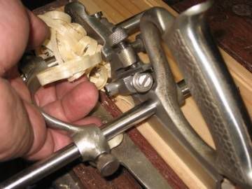

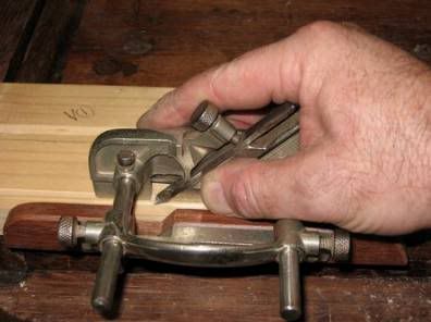

It struck me shortly after I began using the #044 and #043 that these planes were not comfortable in the left hand. I was using them as I had always used them, with the fence rods either extended to the left or centered on the plane body. I would hook my fingers around the rods while my palm pushed against the rounded section. This afforded a firm grip – but after using the Veritas I was acutely aware of the rods interfering with my grip. It was now uncomfortable.
View Image Record #044 side grip
So I changed the way I used them, and mimicked the way they were set up on the Veritas.

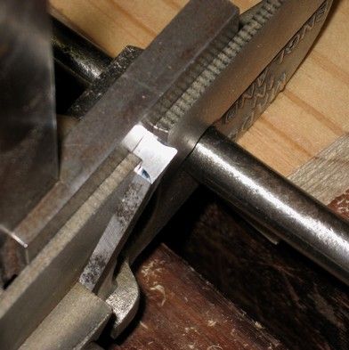

The other feature that is noted in the #044 and #043 is that there is slight racking apparent in the fence rods and their locking mechanism. My first inclination was to just accept this as a feature of wear-and-tear in two vintage planes. However Veritas have paid special attention to this aspect of set up, referring to “a special collet locking system prevent the fence from racking”. A closer inspection uncovers a locking collet (a split tube that is tightened progressively by the knob as it locks the fence). This design effectively banishes any racking due to wear since any wear is taken up by slightly tightening the split tube. It is notable that the Veritas does not display any similar racking. This was one of the features that made using the Veritas such a stress-free experience.

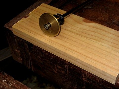

Each pine board was about 9” long. The plan was to cut a ¼” groove with the grain with each of the planes, and compare their results and ergonomics.
All boards were marked ¼” from one edge and planed to a depth of ¼”.

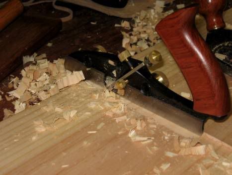

When planing a groove, begin the cut at the end of the board……..
….. then work your way towards the back of the board. Once you have a full groove, you can plane the full length.

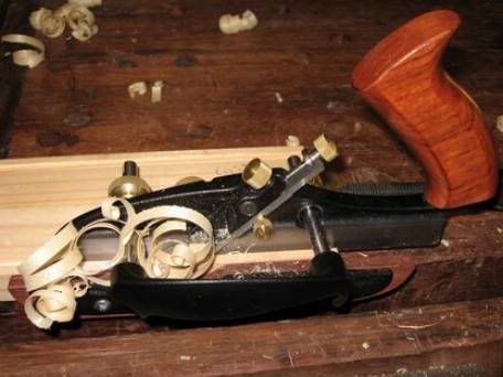

Veritas taking a full-length shaving

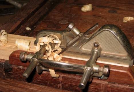

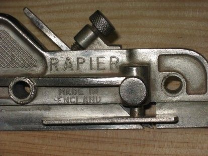

View Image Rapier #043

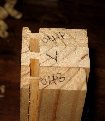

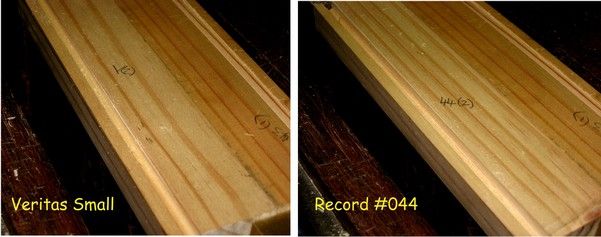

While the Veritas was the easiest plane to set up and the most balanced in use, all three of the planes performed faultlessly in creating a typical drawer groove. The end result was such that it was not possible to pick which plane was responsible for which groove.
Below are examples of grooved boards.

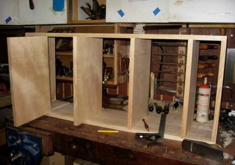

As I mentioned earlier, I did have a current project. This is a Pine and Jarrah bookcase for my son. It has some interesting features, which I shall report on more fully at a later date. For now I am able to use the main carcass to illustrate additional joints created with these plough planes.
The construction involves a large dovetailed frame into which a series of vertical dividers sit in dados. A simple dado is sufficient since a frame will cover the face of the bookcase. The rear of the carcass is rebated all around to accept a paneled back.

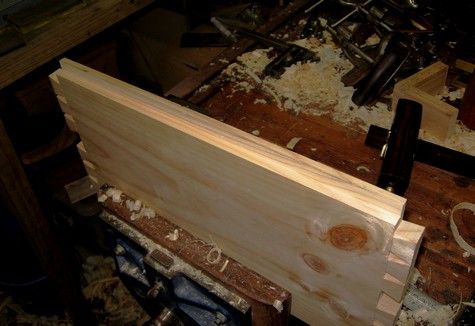

This was the state of play at the conclusion of the current work session …

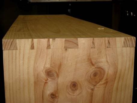

Some detail – the dovetailed ends …

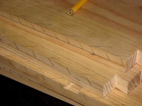

Here are the boards marked and ready for planing.

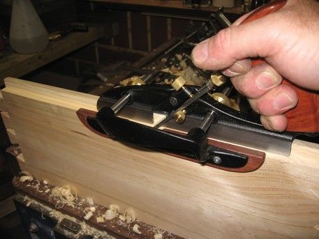

Here is the Veritas planing a 3/8” x ¼” rebate. This was quick and satisfying to complete.

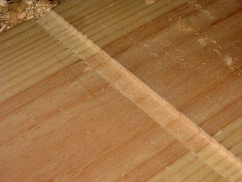

Is the absence of a nicker a problem when cutting a rebate? I would say that a nicker is nice, but it is not essential. There are work-arounds. Here I first scored the lines quite deeply with a cutting gauge (you can just make it out on the right side of the picture below). This helped to define the sides of the rebate.
Finished rebate

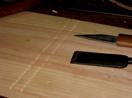

Dados are grooves that are cut across the grain. This is not typically the province of a plough plane. I needed to cut a total of 8 dados. Generally I prefer to chisel-and-rout out (with a router plane) the waste.

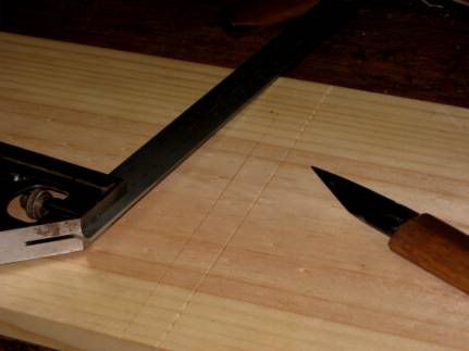

The weakness of a plough plane lies in its lack of a nicker(s) to score the surface when cutting across the grain. This can be overcome by scoring the wood deeply with a knife.
Knifing the lines.
The next step is to chisel out some of the waste against these lines. This defines the outer edges of the dado and may be used as a fence against which the edges may be deepened with the aid of a backsaw. I chose not to do it this way this time, and instead planned to rely on the plough plane to maintain square sides.
Chiseling the waste.
The next step was to define the depth of the dado, which was done with a cutting gauge at both sides.
