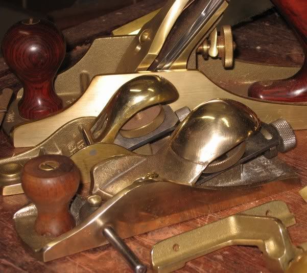

Here it was, surrounded by some more LN bronze ..

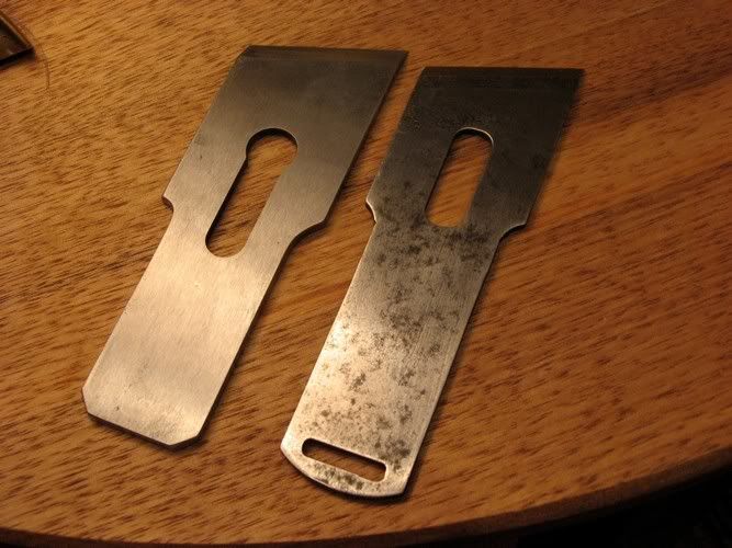

So I contacted Thomas Lie-Nielsen and we found differences in the sizes of parts for this plane and the current LN #140. Thomas said that he would be happy to sort it out, so I sent the plane to him (this must be the most travelled #140 in the world … USA to Australia to USA and back to Australia…. It turns out that the plane was indeed interesting. According to Thomas, it was an early model made around 1985. The bronze used was a different composition. The blade was W1. And slightly wider than current models (so the current model comes from a different casting). Thomas managed to find a thick piece of W1 and had a new (thick) blade made to fit the body.
Here are the blades side-by-side, new and old …

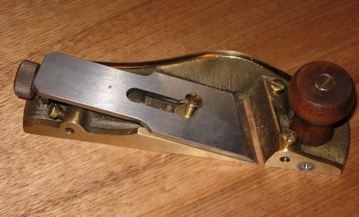

Looking good … new blade and new nicker …

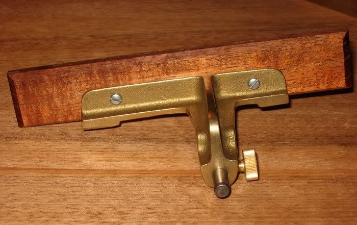

And I thought the new fence was worthy of a slice of Tasmanian Blackwood …
The final result … a really lovely plane …
