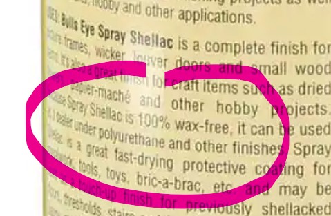

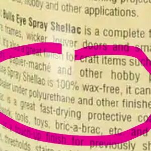

When in doubt a barrier coat of shellac is your friend. For dyes I keep a few cans of Zinsser spray shellac on hand. Wiping shellac over dyes can smear things and make extra work for you.
